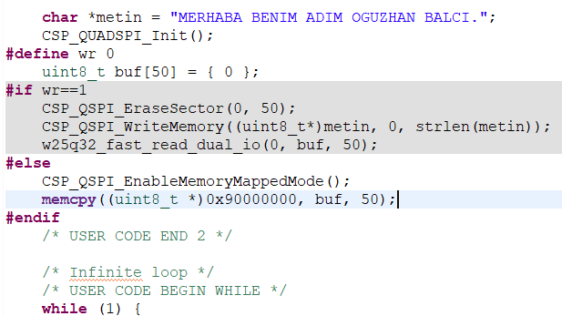

I have been trying to run memory mapped mode using qspi (dual mode) with w25q32jv on stm32f446re nucleo board for a long time. I wonder if what I am trying to do is possible or if I am just wasting my time?
2023-04-16 3:45 PM
The memcpy() is backward
memcpy(buf, (void *)0x90000000, 50); // from mem to buf
>>When I don't use memory mapped mode, I can write and delete in memory without any problem.
You can't use the two modes concurrently. You will need to Abort out memory-mapped mode to get back to direct/command mode.

memcpy not work.
2023-04-16 3:43 PM
I just realized that I am using memcpy wrong
2023-04-16 3:45 PM
