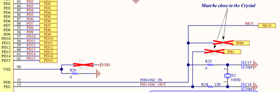

I AM USING STM32F407G-DISC1 BOARD FOR DEVELOPING CUSTOM BOARD.HERE AN OSCILLATOR IS CONNECTED TO PH1 AND PH2 PINS. IS IT IS COMPALSORY FOR DEVELOPING CUSTOM BOARD?
