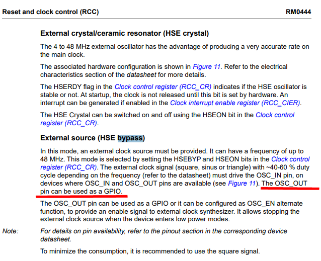

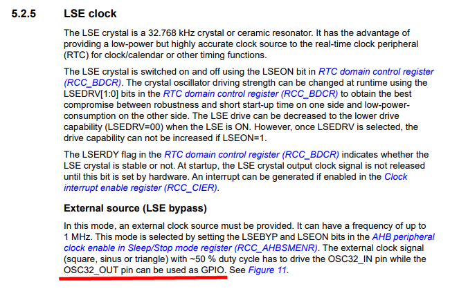

@Welcome_123 wrote:suggest which pin can i connect OSC_OUT
When you're using an external oscillator, you bypass the STM32's internal oscillator.
The OSC_OUT or OSC32_OUT pin then becomes available as GPIO
See the Reference Manual:

2024-10-18 5:45 AM
According to its datasheet:
