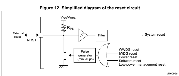

As Clive said, take a quick look on this pic.
Maybe re-check your VDDA/VDD pin and NRST Pin with a oscilloscope.
