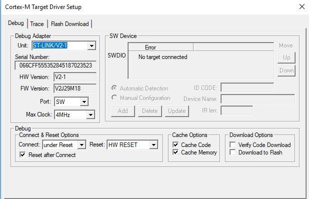

I've an Nucleo-f091rc, and i need using this board to programming an external STM32F070, using SWDIO, I've connected SWDIO, SWDCLK, NRST and GND. My external MCU have external 3.3V. When I try to connect I receive the mesage No target connected.

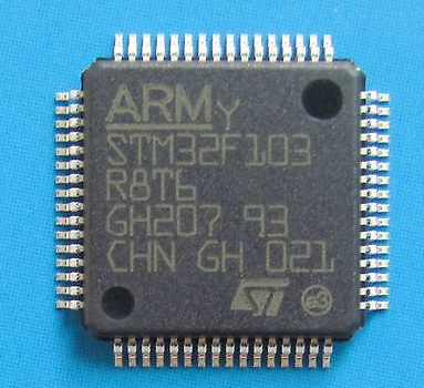

Pin 1 is the smaller, concave mark in the lower-left, and I'm using the pin 1 on
larger mark in the upper-right.

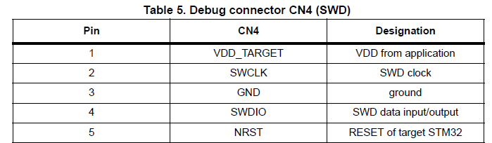

Have you verified your wiring with an ohm-meter (or something similar) down to the pin of your target ?
Aren't you wires too long ?
I've an Nucleo-f091rc, and i need using this board to programming an external STM32F070, ...
The Nucleo user manuals use to have a section about debugging external targets, did you follow it ?

Check part orientation

''The Nucleo user manuals use to have a section about debugging external targets, did you follow it ?''
Yes, I did.

I'm try using Keil to debug
