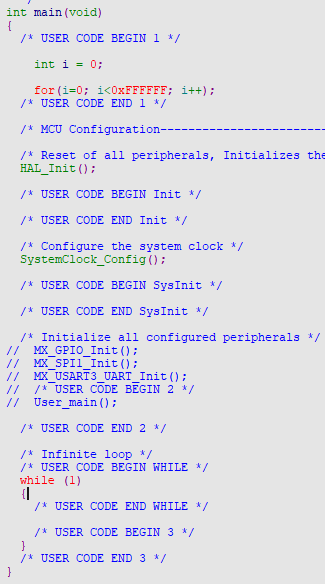

Thank you for your reply.
If the external flashloader is running while the User application is in internal flash, the internal flash program will be halted and remain in reset state.
However, the user application program has only clock settings as shown above.
However, it doesn't work.
There seems to be another problem.
