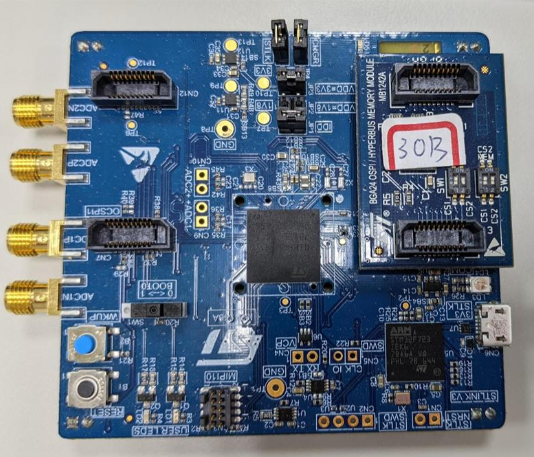

Hello Alex,
Thanks for description and the sample code! I really appreciate it. We are going to produce a new version of prototype board for one of our new products and I will add APS6408L-3OBM-BA on it to test.
What I meant by evaluation board was that if APM had small PCBs with APS6408L-3OBM-BA like in your picture. It would help people to verify the memory with their designs and APM to sell more memory.
