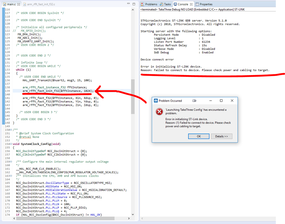

However, I have now run into an issue where including
arm_rfft_fast_init_f32(&fftInstance, 1024);will yield me the error
Why could this be happening? I need the aforementioned code to initialize the FFT, right? It does not give me this error if I only uncomment that particular line (L 139)
