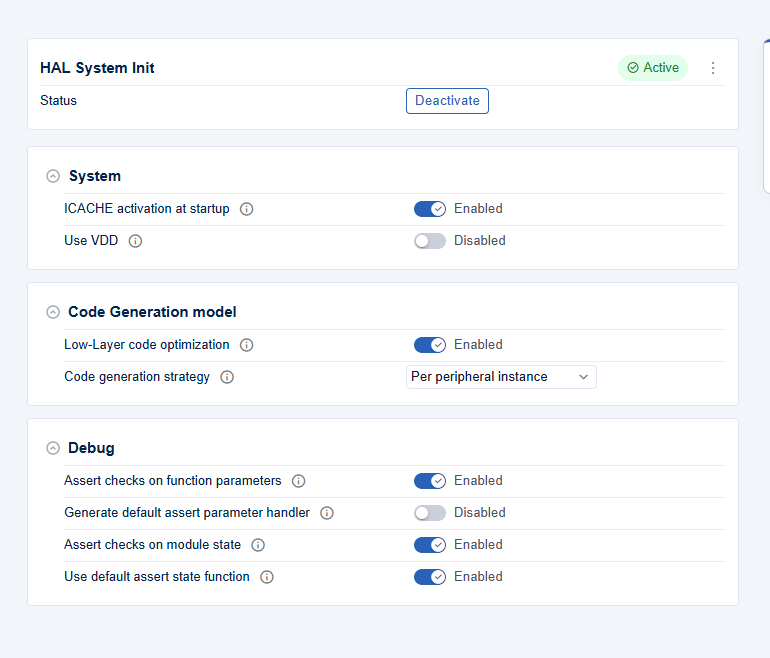

To resolve the issue, you need to enable Use default assert state function and
To resolve the issue, you need to enable Use default assert state function and Generate default assert parameter handler in the HAL System Init configuration. These options are required for the program to build and run successfully when the parameter assert option is enabled. Doing so adds the template implementations of the assert_dbg_param_failed and assert_dbg_state_failed functions in the mx_system.c source file.
To improve visibility of answered topics, please click 'Accept as Solution' on the reply that resolved your issue or answered your question.

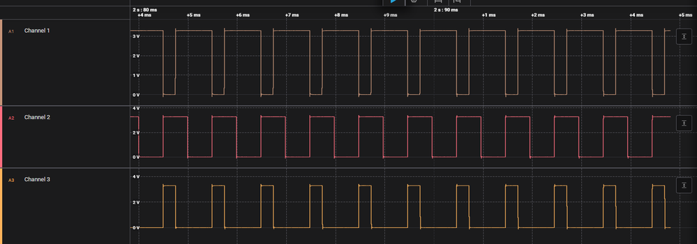

Hello @gil_dobjanschi
After testing, I realized I was mistaken: all the debug options in the screenshot above need to be enabled to generate the necessary functions for the application to work. I tested it with a logic analyzer and confirmed that it works. Attached, you will find the project.
