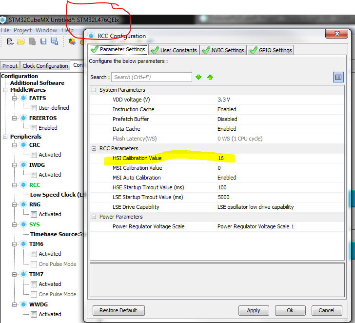

I started a new project using CubeMX Version 4.24.0
The project was for STM32L476QE, the default value is still 16.

,You are right, I checked that
the default value is not correct
withCubeMX Version 4.0 and
I raised this internally to CubeMx team for fix.
