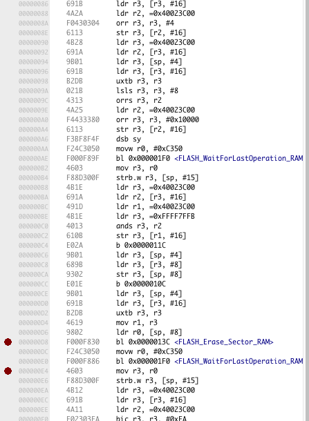

}Single-stepping disassembly is (too small for me to see):
Or as a code-snippet without the addresses

F89D300F ldrb.w r3, [sp, #15]If I execute by single-step the "9802 ldr r0, [sp, #8]" then I get the fault. So by implication we're getting enough speculative-execution of enough of "bl <FLASH_Erase_Sector_RAM>" to start the write. I've specified FLASH_VOLTAGE_RANGE_3 so there's quite a lot of code to execute in:

40023C00 .word 0x40023C00So I'm not convinced of that amount of prefetch/speculative execution.
