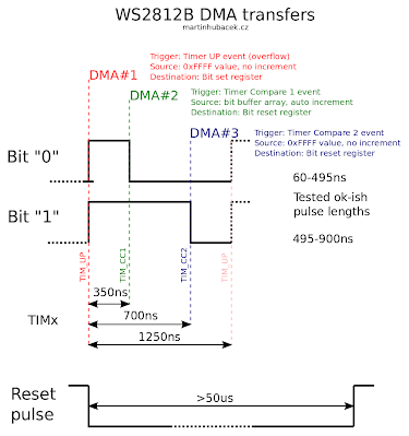

This diagram explains how the timers and DMA's are setup
I checked the relevant datasheets to see if the DMA requests by Timers are available and found that the timer used is supported.
