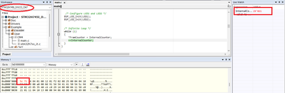

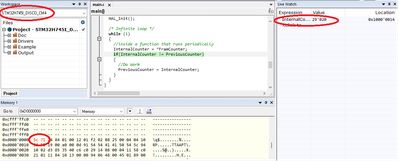

I just did the same test on a STM32H745_DISCO board with an access to two locations: SDRAM and AXI-SRAM using IAR IDE and didn't face any issue. The memory location content is incremented from CM7 side and it is read from CM4 side. No fault faced from both cores:
CM7: showing the written value to SDRAM (0xD0000000):
CM4: showing the read value from SDRAM (0xD0000000):
So I'm sure you have something else in your project. Check also your linker file, could it be a stack corruption?
For your reference, I've attached the project I used for the test. So please refer to the MPU config, the linker scripts. SDRAM configuration is already done in system_stm32h7xx.c by activating the define DATA_IN_ExtSDRAM.
Hope that helps.
Hope that helps.
