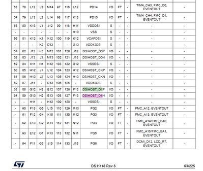

There does not appear to be a GPIO port associated with those pins:
2024-11-13 1:13 PM
No, committed LVDS drivers uncluttered by GPIO baggage..
