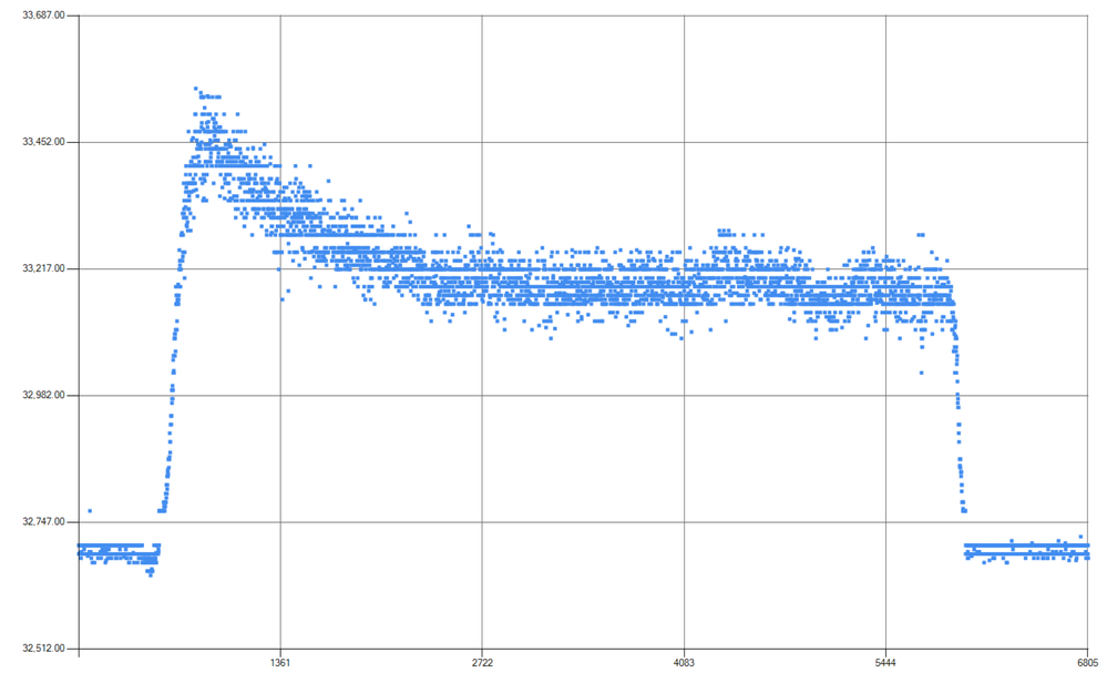

If I connect a constant rising signal at the ADC input, I observe significant fluctuations at certain ADC values. These fluctuations always appear at the same ADC values. The affected values have the following format XX500, e.g. 18500, 19500, 20500 etc.
I was also able to reproduce this behavior with the NUCLEO-H743ZI and the example projects (ADC_DMA_Transfer and ADC_RegularConversion_Polling) from the current cube firmware V1.5.0. The graphic in the appendix shows a recorded ADC values, which shows the problem.
Can someone help me to solve the problem?

This issue concerns more the noise or the behavior in the static state. I got that with the hardware and software filter in the handle. In my case, the dropouts with a constantly rising signal are the problem. These dropouts still occur at the same ADC values. That's why it can not be due to the Ethernet PHY.
