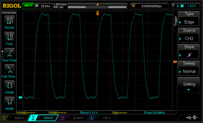

Hardware / 20 MHz:
- the 120 Ohms seem a little high, maybe the flanks are not steep enough for some IO

For series resistor, first I used 27R and I changed to 120R that I read from other forums. Basically from datasheet I saw 5pF input capacitance, so with 120R the cut frequency is pretty high still.

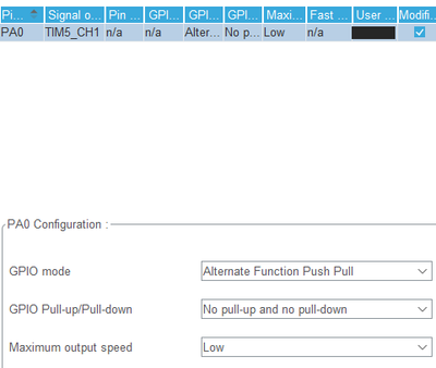

For all GPIOB the output speed is very high as they are configured as digital output. For clock input, I am not sure if I can set high speed for timer input. In GPIO config of cubeide I see this:
I do not know if it make sense to change the "Maximum output speed". The signal is input. Will check this.

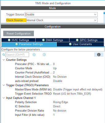

And I have this timer config:

The speed register settings only apply to outputs. But mind that the data lines to a memory are usually bi-directional.
120R: It's not only about the RC-lowpass corner frequency, this is also about flank steepness.
