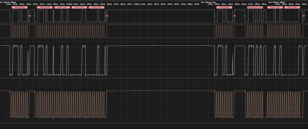

My STM32F401 MCU is a master for communication with an I2C device which requires to write 3 bytes and than read 2 bytes. This cycle repeats each 50 ms. Each cycle includes:
Most of the time every thing works as expected, here is a single cycle:

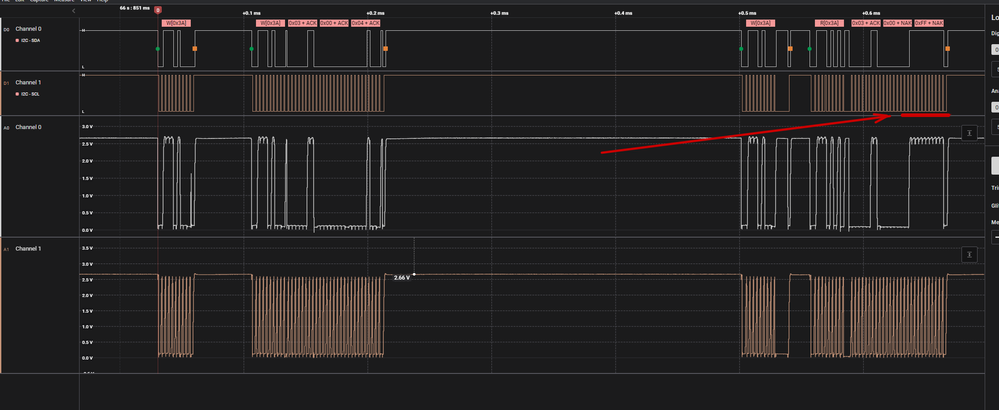

However, randomly (at least I have not seen any pattern) STM generated additional byte transfer in the read sequence, after a NAK has been already generated. The abnormality is the double NAK and than a STOP condition.
I am assuming the STM is generating additional clocks, based on the unchanged analog signal characteristics. Would very much appreciate any help, did any one encountered such behavior before?

The I2C peripheral in the F4 is complicated. Flags need to be handled in a specific timeframe in order for it to work correctly. Do you have other things going on in the program that would delay relevant I2C/DMA callbacks?
Perhaps consider using HAL_I2C_Master_Transmit_IT instead, though I think it also has issues.
