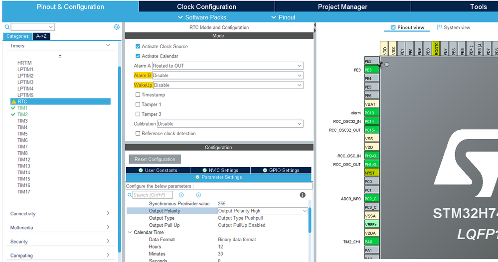

Hi, I am trying to get an alarm signal on pc13 pin but without success, could you give an example? I turn on alarm A (Routed to OUT), the interrupt occurs but nothing changes on the output.Screenshot_8.png
Denys_T
Associate III
It seems I found what was wrong, I carried out tests without turning off VDD and expected to see a signal on PC13 but nothing happened, but as soon as I turned off VDD the alarm signal appeared =))
