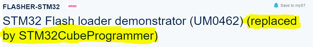

2021-07-11 11:34 PM
Hello @Lkim.1 ,
You should use STM32CubeProgrammer instead of Flash Loader Demo, especially that the latter support newer parts.
Best regards,
@SBEN .2

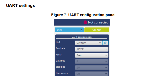

2021-07-12 12:14 AM
Hello @Lkim.1 ,
Flash Loader Demonstrator is deprecated and isn't guaranteed to work on newer parts.
Please check section 2.1.4, figure 7 for the steps you need to follow in STM32CubeProgrammer's user manual: https://www.st.com/resource/en/user_manual/um2237-stm32cubeprogrammer-software-description-stmicroelectronics.pdf
Best regards,
@SBEN .2
2021-07-12 5:16 PM
Hello~ : ) thanks for your kindness reply
I'be tried what you said. using STM32CubeProgrammer, with UART connect.
but it still doesn't connect well..
it shows error which is "Error: Activating device: KO. Please, verify the boot mode configuration and check the serial port configuration. Reset your device then try again... "
so I think I need to check one by one.
I need your help really ,,
I have no Idea what should I do next...
