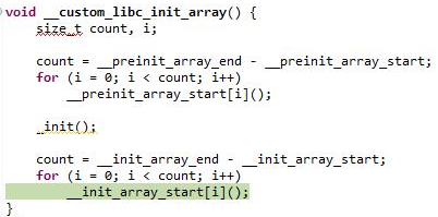

I'm having trouble with a hardfault occuring in libc_init_array function call in startup file. Using disassembly in debug mode, I can see that the instruction that causes the issue is "blx r3" which jumps at address 0x0. At this point, the r3 register value is 0x0.
According to ARM documentation, the blx instruction exchange the instruction set. I've then tried to write the libc_init_array function in my project asI thought maybe the external libc_init_array function used was not compiled with the right instruction set.
Though this does not fix my problem, I am able to see that the jump at 0x0 address is due to callback call using an array of callback named "__init_array_start" that is initialized with 0x0, in the libc_init_array function.
I'm now stuck at this point and don't really know where to look next.
I've looked into the linker file and the map file, I've tried to modify compiler and linker options but without success so far.
Also, the compiler optimization flag is set to -O1. Setting it to -Os prevents from entering the libc_init_array harfault at startup but brings up more issues later. Moreover, using optimization is only a short term solution.
Do you have any idea on what is causing this harfault ?

__init_array_start marks the start of an array of function pointers. These are used for static constructors in C++ and maybe used for other purposes. There should be definitely no NULL pointer in that array. Thats what happening in your code.
It no so easy what causes this behaviour. You could try to start a new default project for your MCU and compare.
You could also halt the debugger of your project at the very beginning (Reset_Handler) and step through the init code.
AFAIK there is, by default, one function pointer in that init arry, a function named frame_dummy. This could be the one at line 14950 in your mapfile.

Coming from
c:/tools/tlc/compilers/gcc.git/10-2020-q4-update/bin/../lib/gcc/arm-none-eabi/10.2.1/thumb/v6-m/nofp/crtbegin.o
If this isn't a CPP/C++ app you can safely remove the call in startup.s

I've been investigated why the __init_array_start array in libc_init_array is 0x0 and it turns out that the complete second half of the flash memory is filled with 0x0. I can see in debug mode that from 0x08010000 to 0x08020000 the flash is empty.
The MCU has a 128ko flash but only 64ko is written although both the map file and the binary use addresses in the second half of the flash. Very confusing to me !
I figured it out by relocating the .preinit_array, .init_array and .fini_array sections in the linker file before the .rodata section. In this confiugration, the libc_init_array does not cause any trouble, given its corresponding flash sections are located in the first 64ko of the Flash. The application will however crash as soon as it uses data from the second half of the flash.
I feel I'm really close to solving my problem but I'm still stuck tyring to find out why the second 64Ko of the flash is not written.
I've found that the mcu has a dual bank feature and perhaps the second bank must be enabled or configured in the linker file or somewhere else.
