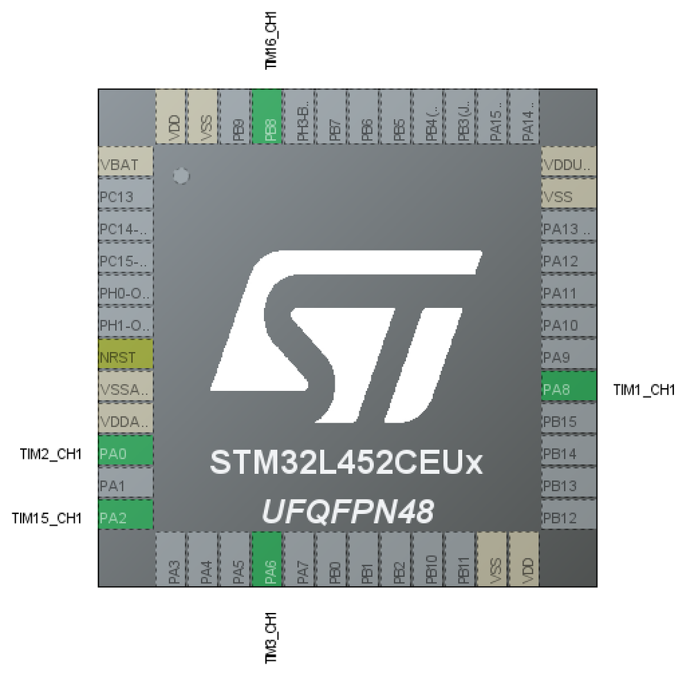

You can have 5 independent PWM signals on that chip. Each timer output pin can be PWM, but channels within the same timer must have the same frequency.
