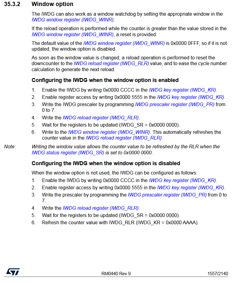

I’m working with an STM32G473QETx.
Does the IWDG window value cause the MCU to reset if the watchdog is refreshed too often (i.e., refreshed too early)?
if I set the IWDG window value to something smaller (e.g., 1600), will the MCU reset if I refresh the watchdog more frequently than expected?
Any clarification on how the IWDG window works on the STM32G4 series would be appreciated.

the newer STM32 - including 'G4 - have window option in the IWDG. And then if IWDG_WINR is set to a value lower than IWDG_RLR, it can cause reset if the watchdog is refreshed too soon after previous refresh.

Thank you for your reply. Suppose I don’t need to use the IWDG window option — what value should I set? I configured the IWDG timeout to 1.5 seconds by using a prescaler of 32 and a reload value of 1600 based on my clock frequency. The IWDG window value must be between 0 and 4095. Which value should I set to effectively disable the window option?

2026-01-31 2:40 AM
Anything higher than (or equal to) the reload value.
As said in the description quoted by @Chris21 above, leaving IWDG_WINR at its default 0xFFF is sufficient.
