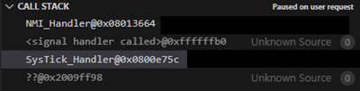

From what I can see in the Call Stack, every single time I detect the issue, the interrupt seems to arrive/trigger when I am inside of a task switch. Example of the call stack:
So, here we have a task that has called vTaskDelay. The code pointed to in the delay function is portYIELD_WITHIN_API. My understanding is that this will cause a jump to

Which asm instruction we are at changes from run to run, but in this case we are at
stmdb r0!, {r4, r5, r6, r7, r8, r9, sl, fp, lr}
Here it looks like we get a CAN Rx interrupt. We end up in the handler for that interrupt, and traverse down to where it wants to put some data into a queue. The queue is very large and therefore will not be full. The memcpy is referred to in the call stack is the copy of the data into the write position of the queue.
The variables/pointers used in the memcpy looks to be OK.
After the memcpy we seem to end up in the NMI handler. I do not know why. I have tried to modify the NMI handler to see what the issue is but without luck. My NMI handler:
