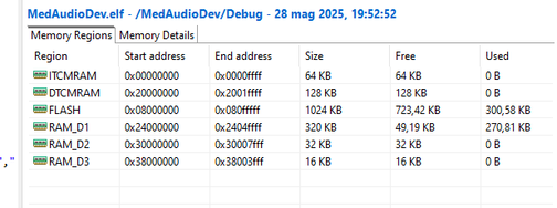

2025-05-29 12:26 AM
GREAT !
I've used the "attribute section" and it works good:
float32_t accL[6000] __attribute__((section("DTCMRAM")));
float32_t accR[6000] __attribute__((section("DTCMRAM")));
float32_t float_buffer_L[6000] __attribute__((section("DTCMRAM")));
float32_t float_buffer_R[6000] __attribute__((section("DTCMRAM")));
the four buffers seem to be placed in the DTCMRAM area:
arm-none-eabi-size MedAudioDev.elf
text data bss dec hex filename
211572 96220 181092 488884 775b4 MedAudioDev.elf
Finished building: default.size.stdout
even if it doesn't appear in the Build Analyzer...
Thank you
