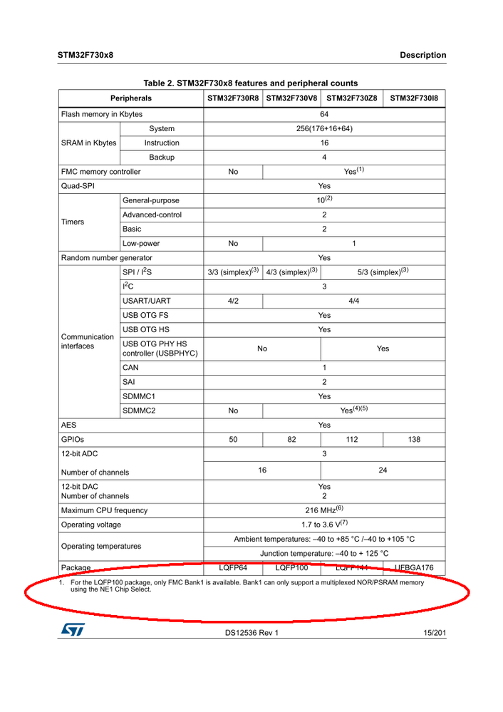

It says specifically in datasheet that it does, but when I create new STM32CubeIDE project and select STM32F730V8, FMC only offers PSRAM/NOR Flash/LCD interface. I tried for testing purposes selecting some other MCU that also supposedly supports SDRAM, I did get a choice of selecting it. Am I doing something wrong?

Does the selected package have all pins needed for SDRAM?

Minimum package size is 144-pins, so I'm guessing so.

Damn, I missed that part. Thanks.

Yes, I've just realized that. Thanks.

But it says that for STM32F730V8T6, which is 100 pin package, doesn't support SDRAM?
