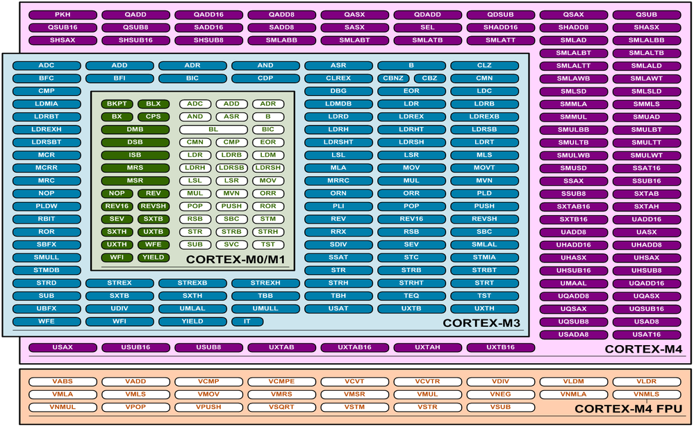

2018-07-01 8:37 AM
None of the Cortex-M parts support 32-bit ARM Instructions
The Cortex-M0 supports a shrinking set of 16-bit Thumb Instructions, which means you might need to use a couple instructions to perform an operation where one instruction on a CM3 or CM4 would suffice.
