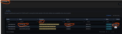

2026-01-05 11:48 PM
Seems it is trying to download the 1.1.1 dfp pack version but something is going wrong, could you please check which pack version is installed and try to manually update it
