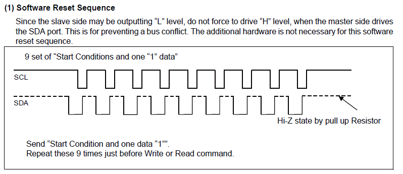

Such “commands�? specified by this FRAM IC vendor are supposed to set “Speed Modes�?, set a “Sleep Mode�?, etc.
This require sending multiple START conditions followed by some data.

2023-04-17 1:52 PM - edited 2023-11-20 7:53 AM
From the FRAM IC spec: "9 set of Start Conditions and one "1" data"
