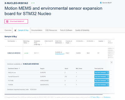

For you information, the X-NUCLEO-IKS01A1 is Not Recommended for New Design as shown in this link.
So, you can use this link to buy X-NUCLEO-IKS01A3.
Thank you.
