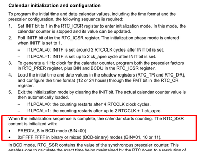

This matches the description in RM:
The reason for this is to ensure that the first calendar (seconds) increment happens exactly one second after the initialization is finished (i.e. that the calendar can be run sub-second perfect).

2024-03-29 2:25 AM - edited 2024-03-29 2:26 AM
