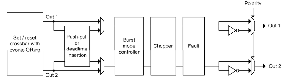

According to the Reference Manual, "Once a fault has been triggered, the outputs take a predefined safe
state. This state is maintained until the output is re-enabled by software.". There is no deadtime when a fault occurs, all outputs are forced to the low level in case of FAULT event.

I discovered this presentation:
And looking at page 36. There appear to be a dead time insertion on fault.
Or is this related to "Burst mode delayed entry" and the DIDL bits. If this could be used without actually using the burst mode controller, that might acheive want I want.
