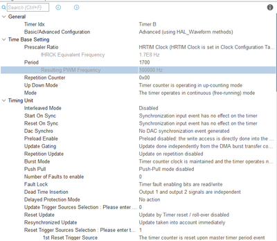

There are many possible solutions, such as the chopper feature, but below is the simplest one: Since FSK needs to modulate PWM frequency for both mark ('1') and space ('0') with different frequencies, you will need to adjust this frequency each bit period, in this case, 10 µs. Therefore, you will need two timers: one for PWM generation and another for bit timing. When the bit timer expires, you will modify the PWM timer to match the bit frequency.
This is the configuration for Timer B, which is used to handle the bit timing of 10 µs, leading to 100 kHz. The interrupt is enabled at the timer reset:

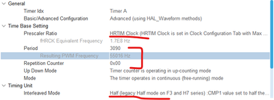

This interruption should be used to modify the second timer period, Timer A, in order to handle a new PWM frequency as shown in the screenshot below:
This timer is used for PWM, with 55khz frequency, and half mode for PWM generation, so modifying the period will keep a 50% duty cycle, at Timer B interrupt routine, SW/User should modify the period of this timer, to decide about the frequency, 45khz to generate bit1, 55khz as configured initially to generate bit0.
