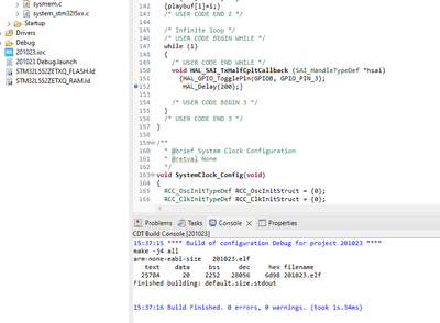

2023-11-14 1:30 AM - edited 2023-11-14 1:32 AM
Thank you for your helps, I'll look for the documentation for that. I modified my code to know if the transmission is correct via the HAL_SAI_TxHalfCpltCallback function :
while (1)
/* USER CODE END WHILE */
void HAL_SAI_TxHalfCpltCallback (SAI_HandleTypeDef *hsai)
{HAL_GPIO_TogglePin(GPIOB, GPIO_PIN_3);
HAL_Delay(200);}
/* USER CODE BEGIN 3 */
So for me something is wrong with the transmission since the LED never flashes.
2023-11-14 5:02 AM
You got it completely wrong...
You are declaring a function within the while loop - and the compiler does not complain? Interesting.

2023-11-14 6:42 AM
I'm not sure if you're right, no errors during compilation :
I saw a tutorial and you can do this to find out if the transmission is going well. The proof is that I have no errors during compilation.

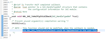

2023-11-14 6:55 AM - edited 2023-11-14 6:57 AM
I think this function is useful to know if the transmission is going well.
Why am I looking at this function ? Because the DMA is configured in circular. After I can check for RX.
Normally the interrupts is automatically generated by cubemx right ? How to check this interruption ?
