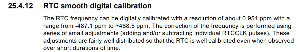

I would also like to draw your attention to the possibility of calibrating the RTC on the STM32, for which there is a function called smooth calibration, among other things, with which you can, however, increase the deviation of the oscillator frequency somewhat with a resolution of about ±0.95ppm. Details can be found in the respective reference manual under smooth calibration or e,g, in this thread.

10..20ppm is best for crystal clock. when temp. is not too extreme, you can get very good precision with the trimming:
this is for setting some correction factor in RTC , but you need to do for every crystal .
