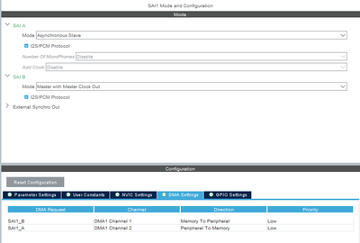

With CubeMX I have configured 2 DMAs.
One to send the data and the other to read the data again.

2023-11-10 1:39 AM - edited 2023-11-10 1:42 AM
Hi Imen,

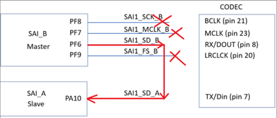

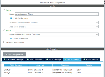

Thank you for your feedback but I my goal is not to check the example programs. I've seen 2 examples and it doesn't match what I'm doing. Especially since there was no '.ioc' file so we can't see anything. So I can give to you my configuration and the purpose of my test. I just want to send the data through the SAI (playbuf) and retrieve (playbuf_RX) it in a table to validate the operation of my SAI. I created 2 buffers one for sending and the other for receiving. I looped the TX with the RX together
I configured the SAI with DMA, one for sending and the other for receiving :
If I initialize my sending table then in principle I must have the same values as in my receiving table right ?
Thank you for your helps.

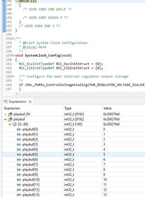

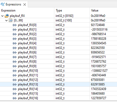

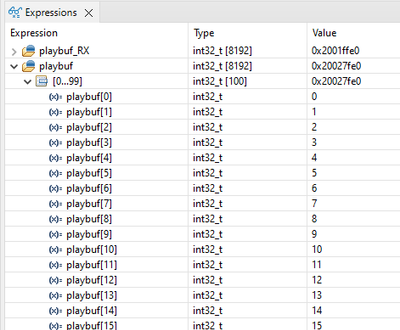

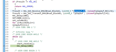

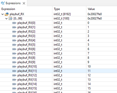

2023-11-10 5:46 AM - edited 2023-11-10 6:10 AM
After your advice
fresult = HAL_SAI_Receive_DMA(&hsai_BlockA1, (uint8_t *)playbuf_RX, (sizeof(playbuf_RX))/4);
fresult = HAL_SAI_Transmit_DMA(&hsai_BlockB1, (uint8_t *)playbuf , (sizeof(playbuf))/4);
And I filled my TX array (playbuf) like this
I make a breakpoint and I watch the array playbuf_RX :
For me there is no transmission. What's wrong ?
2023-11-10 6:22 AM - edited 2023-11-10 6:25 AM
something....wrong. :)
what cpu we have here? (H7 -> disable d-cache ! )
+ preset arrays before starting dma .
1. check with a scope...clk, wclk generated really ?
2. set a breakpoint at receive callback - then you know, its coming there at all !
