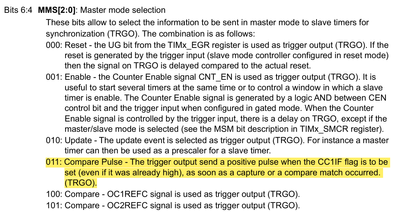

I am currently trying to trigger a DMA request with TIM12. I have configured the timer in PWM Input Mode on CH1. While for every other timer there is available a DMA request, there is nothing for TIM12 except the one bellow(in RF0399):
Is there any trick to come around from it? I found some older discussion but i didn't have any luck:

The only event from TIM12 with a DMA trigger is TRGO, as you saw. No way around that.
The TRGO event is configurable. Luckily, you can set it to trigger on the CC1IF flag which is exactly what you want.
Might not be clickable in STM32CubeMX but the hardware definitely supports it.
