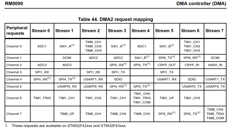

// DMA_Config
static void DMA_Config(void)
RCC_AHB1PeriphClockCmd(RCC_AHB1Periph_DMA2, ENABLE);
DMA_InitTypeDef DMA_InitStructure;
DMA_StructInit(&DMA_InitStructure);
// ADC1, DMA2, Channel0, Stream0 configuration
DMA_DeInit(DMA2_Stream0);
DMA_InitStructure.DMA_Channel
DMA_Channel_0
DMA_InitStructure.DMA_Memory0BaseAddr = (uint32_t)&ADCConvertedValue[0];
DMA_InitStructure.DMA_PeripheralBaseAddr = (uint32_t)&ADC1->DR;
DMA_InitStructure.DMA_DIR = DMA_DIR_PeripheralToMemory;
DMA_InitStructure.DMA_PeripheralInc = DMA_PeripheralInc_Disable;
DMA_InitStructure.DMA_MemoryInc = DMA_MemoryInc_Enable;
DMA_InitStructure.DMA_PeripheralDataSize = DMA_PeripheralDataSize_HalfWord;
DMA_InitStructure.DMA_MemoryDataSize = DMA_MemoryDataSize_HalfWord;
DMA_InitStructure.DMA_Mode = DMA_Mode_Circular;
DMA_InitStructure.DMA_Priority = DMA_Priority_High;
DMA_InitStructure.DMA_FIFOMode = DMA_FIFOMode_Enable;
DMA_InitStructure.DMA_FIFOThreshold = DMA_FIFOThreshold_HalfFull;
DMA_InitStructure.DMA_MemoryBurst = DMA_MemoryBurst_Single;
DMA_InitStructure.DMA_PeripheralBurst = DMA_PeripheralBurst_Single;
DMA_InitStructure.DMA_BufferSize = ADC1_SENSORS;
DMA_Init(DMA2_Stream0, &DMA_InitStructure);
DMA_Cmd(DMA2_Stream0, ENABLE);
// ADC2, DMA2, Channel1, Stream2 configuration
DMA_DeInit(DMA2_Stream2);
DMA_InitStructure.DMA_Channel = DMA_Channel_1;
DMA_InitStructure.DMA_Memory0BaseAddr = (uint32_t)&ADCConvertedValue[ADC_BUFFER_SIZE];
DMA_InitStructure.DMA_PeripheralBaseAddr = (uint32_t)&ADC2->DR;
DMA_InitStructure.DMA_BufferSize = ADC2_SENSORS;
DMA_Init(DMA2_Stream2, &DMA_InitStructure);
DMA_Cmd(DMA2_Stream2, ENABLE);
// ADC3, DMA2, Channel2, Stream1 configuration
DMA_DeInit(DMA2_Stream1);
DMA_InitStructure.DMA_Channel = DMA_Channel_2;
DMA_InitStructure.DMA_Memory0BaseAddr = (uint32_t)&ADCConvertedValue[ADC_BUFFER_SIZE*2];
DMA_InitStructure.DMA_PeripheralBaseAddr = (uint32_t)&ADC3->DR;
DMA_InitStructure.DMA_BufferSize = ADC3_SENSORS;
DMA_Init(DMA2_Stream1, &DMA_InitStructure);
DMA_Cmd(DMA2_Stream1, ENABLE);
2014-08-20 7:18 PM
Isn't the point of triple mode to lock step the ADCs, use a single DMA stream, and read from the common data register, not the ADCx->DR? If you want it to work in Independent Mode, configure it that way.

// DMA_Config
// ADC common data register, DMA2, Channel0, Stream0 configuration
DMA_Channel_0
DMA_InitStructure.DMA_PeripheralBaseAddr = (uint32_t)&ADC->CDR;
DMA_InitStructure.DMA_BufferSize = ADC1_SENSORS + ADC2_SENSORS + ADC3_SENSORS;

// DMA_Config
DMA_Channel_0

The code above still has the DMA memory loss of sync problem. However, it is only a problem when running in the debugger (I'm usingKeil uVision). Running full speed the ADC DMA transfers work perfectly.
For the debugger, I have a hack that gets it to work when executing in the debugger. See the code below. I thought I'd post the final solution as there seems to be no mention of this problem on any forums.const INT ADC_BUFFER_SIZE = 8;
static __IO uint16_t ADCConvertedValue[ADC_BUFFER_SIZE*3] __attribute__((at(0x20002000)));
struct ADC_ConfigData
uint16_t GPIO_Pin;
GPIO_TypeDef* GPIO_Port;

// ADC_IRQHandler
extern ''C'' void ADC_IRQHandler()
ADC_ClearITPendingBit(ADC1, ADC_IT_EOC);
DMA_Cmd(DMA2_Stream0, DISABLE);
// When using the uVision debugger the DMA controller loses sync with
// the destination memory location within the array: ADCConvertedValue[].
// Running full speed without the debugger this ISR hack is not required.
// Setting the stream number of data registers at the ADC end of
// conversion fixes a problem with the DMA controller losing sync. Initially
// the data loaded into the array is correctly positioned, then over time it
// loses sync and starts copying the data to the wrong array index causing bad
DMA_Channel_0
