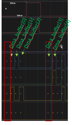

In white is the PWM signal and the last 4 channels are the GPIOs I'm trying to read.

And here are the corresponding signals:
so first of all DMA_buffer[0] is: 1000000100, the value that im looking for is GPIO 1 to 4 so the value is 0100 which correspond to the second rising edge of the clock. I have shown the buffer values to the signal in the picture of the logic analyser. DMA_buffer[1] is 1000. which is also good if we follow the logic analyser and finally DMA_buffer[2] is 0010. The LSB being the orange signal.
The problem seems to be always on the first DMA transfer (The Red rectangles in the picture). It seems each multiple of 4 DMA triggers is wrong or not even sent.

2025-01-21 12:32 AM
Hello, I believe I have found my mistake.
My time15 trgo was set to oc1_ref. After checking in the documentation I have tryed to set it to oc1 and now it seems to work for all sample excep the first one. I can live without the first sample.
I'm not too sure why my first configuration was close to working (with oc1_ref).
If anyone more knowledgeable could explain that part I would appreciate, simply to better understand the timer inner workings.
