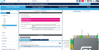

In STM32CubeMX here the possible PVD levels configurations:

From MX Cube I see, that PB7 is configured as analog with no pullup/down.
This was also my intention but i didn't find it in the docs.

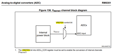

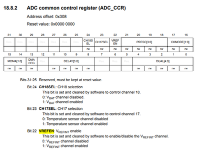

For ADC conversion of VRefInt VREFEN of ADCx_CCR must be enabled.
Can PVD use VRefInt Independent of ADC and VREFEN?

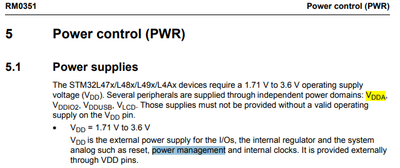

Sorry, I made a mistake and I misled you. I mixed up the VREFINT bandgap with the VREFBUF.
I'm referring to RM0351 in section 5 Power control (PWR)
When PLS[2:0] = 0b111 in PWR_CR2 register. The external input analog voltage PVD_IN is compared internally to VREFINT. It's independent from ADC.
