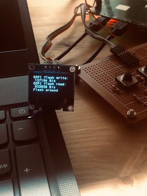

Hi Imen,
Well, it is working, the Rx and Tx callback functions are firing and I can measure the time it takes to read and write QSPI flash memory. One thing, the Reading and writing of QSPI flash memory without DMA, doesn't cause the callbacks to execute. I am assuming that I probably need to disable the DMA channel for that to work? I am posting a code snippet of the case statements for writing and reading QSPI flash memory. The transfer rate seems a little slow. The write to flash is 127KB/s and reading flash is 632KB/s. Does this seem right?

2020-10-17 9:01 PM
Now I am reading 1.4 MB/s.
