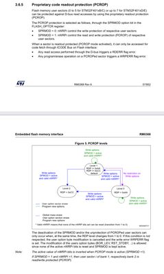

Dear @themarcman ,
This may help , indeed that bit for PCRoP feature is a bit special and to reset it , and RDP change is required on same time . Can you try using the STM32CubeProgrammer GUI instead and use unitary operations .

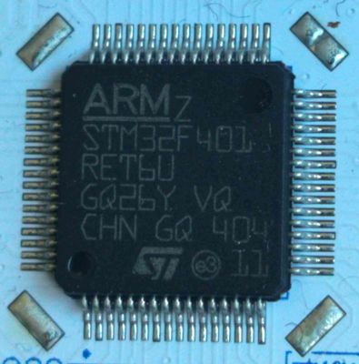

Dear @themarcman ,
Can you please provide the device marking on top of the package and also confirm if other Erase/programming operations on the flash are working fine? so only sector write protection, or/and any modification of options bytes is also not working?

2025-04-05 5:50 AM - edited 2025-04-05 6:11 AM
Here is the device marking on top of the package as requested.
package

I am able to change RDP (Read out Protection) from AA to BB an back, but SPRMOD is set and I am not able to disable it as well.

2025-04-05 9:55 AM
Thank you so much this solved it.
I remember reading around this area but I stopped right before because it did not seem relevant.
I first changed RDP to level 1.
Then in one go changed RDP to 0, SPRMOD to 0 and all RPx to 0.
My understanding is operations on RPx can only be done during this specific transition of the state machine.
I then switched SPRMOD to 1 again because I could not flash code otherwise and this fixed my problem.
Not sure if I could've simply switched RPx to 0 during that transition without SPRMOD, I'm still don't fully understand this.
