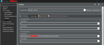

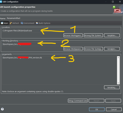

Second step is to create a new builder and inserting it into the project:
So, right click on the project, properties --> Builders --> New.
Compile the step 1,2 ,3 with your preference:
"1" is the "bash.exe" program present on GIT folders
"2" is your project folder
"3" is the script locations (I.E. = ${workspace_loc:/TestProject/FW_version.sh}  )  [pay attention to the syntax]
Last step is compile your post-build command with : ${workspace_loc:/TestProject/.externalToolBuilders/RenameArtifact} [pay attention to the syntax]

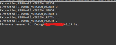

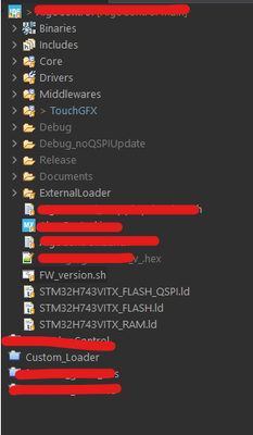

if everything works correctly, when you compile your code you will obtain the following result:
(in my case I used the script on the debug configuration. if you need, change it to release or something else configuration).

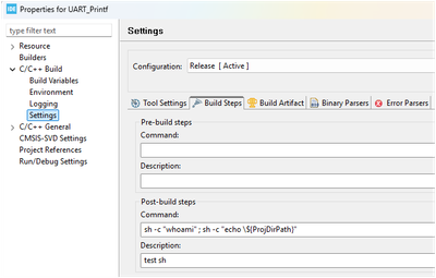

The post-build command goes into the project settings:
As you see, CubeIDE variables can be used in the commands, with ${...} syntax.

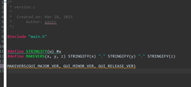

To get the version as string: make a small C file, for example ver.c  ver.h  [edited - use .h suffix so that Eclipse won't add it to the project as a source file]
#include "main.h"
#define STRINGIFY(w) #w
#define MAKEVERS(x, y, z) STRINGIFY(x) "." STRINGIFY(y) "." STRINGIFY(z)
MAKEVERS(GUI_MAJOR_VER, GUI_MINOR_VER, GUI_RELEASE_VER)

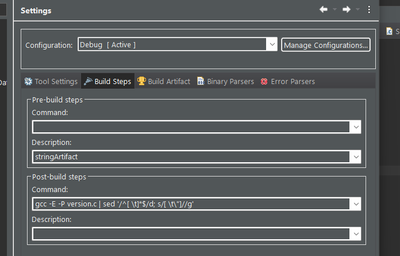

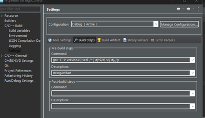

hi @Pavel A. ,

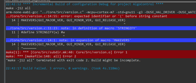

I create "version.c"
I inserted these in pre-build:
And I obtain an error:
But I'm in trouble with the compiler in use:
 trying to put on post-build command
I get this error:

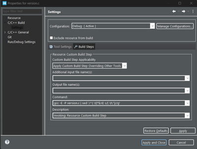

Hi @Pavel A. ,
 maybe I have done a little bit of confusion.
After reading for 100  times your original message, maybe I understood the right steps to do :
right click on "version.c" -> proprieties -->settings --> build Steps..
In this way everything is compiling without any error, but Output file has still the project name.
