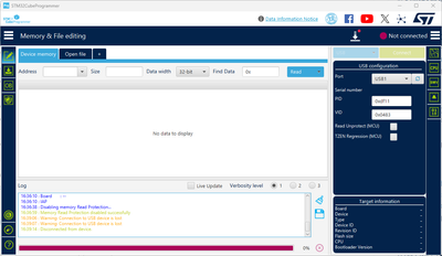

I tried to use USBX DFU to update the firmware on the STM32U575ZI. The DFU mode was detected by STM32CubeProgrammer. However, when I clicked the connection button and disabled Read Out Protection, STM32CubeProgrammer was frozen as shown in the following picture

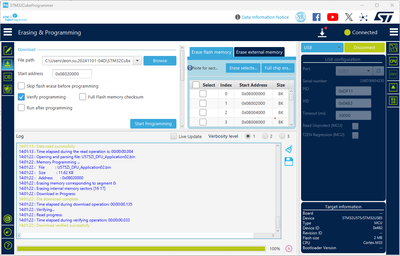

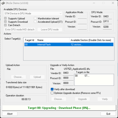

Moreover, I tried to use DfuSe Demo to update the firmware. It erased the flash (I double‑checked this with STM32CubeProgrammer), but it could not write data to the MCU, as shown in the following picture.

Dear @LeonSu ,
Are you using the Factory embedded bootloader or the DFU IAP example in main flash ?, if it is the second case - it may happen that the DFU code (in charge of the operation) Erased itself and whole flash so Both Tools will hang as the firmware of DFU also is erased. To check that, please share setup of the DFU code used ( Hex file ) and also the new Application ( hex code - such as Application2.Dfu.. or like) .

1. I entered DFU mode by connecting PH3_BOOT0 to VDD, and then used STM32CubeProgrammer to update the firmware U575ZI_Application02. The update works well, as shown in the following picture.

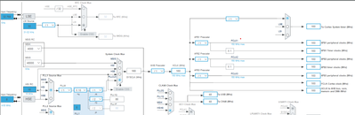

2. The Nucleo-U575ZIQ does not set up the HSE crystal, so I chose the LSE crystal as shown in following picture.

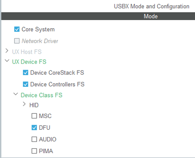

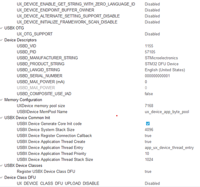

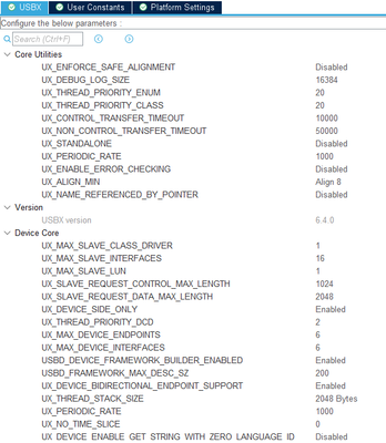

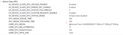

My USB configurations are shown as follows
USBX
(1) Mode
(2) Configuration
