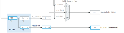

my RGB display does not have a buck boost converter nor a controller iC , so to give power i am using DC adapter with 12 v to enable backlight , and for data and clock i am using LTDC hardware in 16 bit mode. connections are made with jumber cables from my dev board to LCD , and when i turn it on i am getting a black screen , and when i power off it turns white so that means LTDC may be working . but i also have a framebuffer stored in external ram and that address is passed to LTDC so i should see some colors on the display but right now i am only seeing black screen.

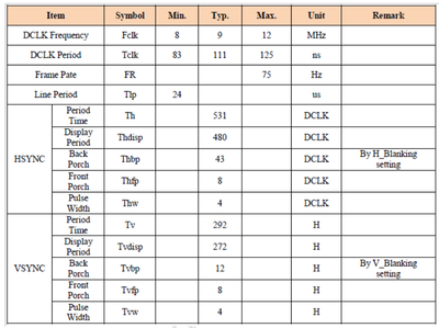

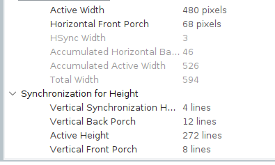

LTDC timing and clock frequency are configured using this datasheet of my display .

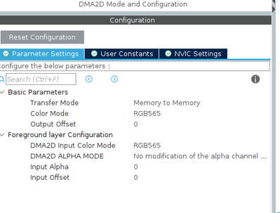

also dma is too configured for this
but no matter what i do i am getting black screen ,

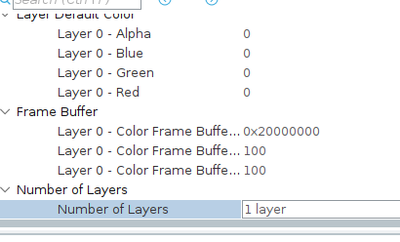

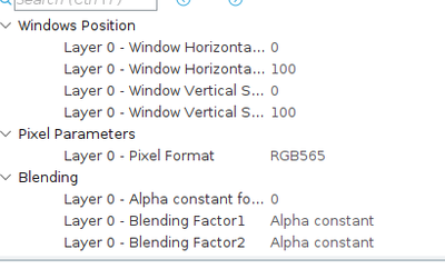

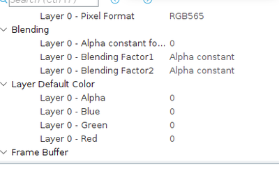

DMA2D is here irelevant. Primary condition is external RAM is ok working. Better is make first testing in internal RAM. Use layer 0 windows 100x100 px and create framebuffer in internal ram... Set background colors not black for testing. Show here your layer config. For example RGB565 require setup right alpha nums.
2025-11-09 6:48 AM - edited 2025-11-09 8:26 AM
now i changed to 100x100 resolution to match the internal RAM
buffer start adddress set to internal RAM address also changed the alpha constant to 255 still not working
edit : probably issue with the external RAM , i tried with some GDB and with some breakpoints , if i store the framebuffer in external ram i get hardfault_hadler , if i change to internal ram gdb is running okay , so i think issue is with external RAM.
