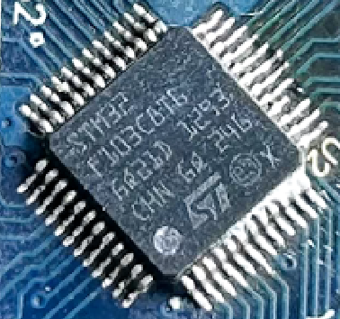

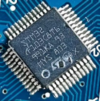

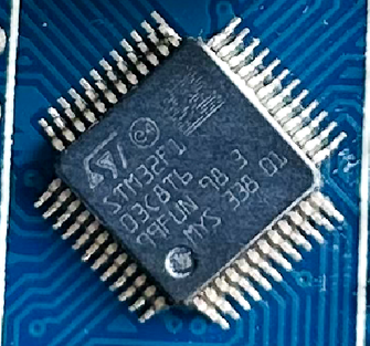

The microcontroller which is working properly
The microcontrollers which have issues with receiving data.

I am 100% sure that there is at least one counterfeit among your devices, which can/will always happen if you buy STM32 from unauthorised dealers. You should check the devices again carefully, for which there are now a number of tools from users, e.g. from GreaseWeazle
Good luck!
