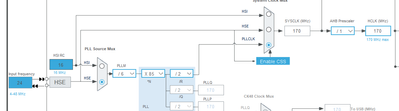

What clock are you using as source for the PLL ?
2025-05-16 5:47 AM
2025-05-16 5:56 AM
The Nucleo G474 has an external XTAL please use it, hopefully it will improve accuracy,
configure Crystal/ceramic for HSE as follow:
Select HSE as input for the PLL and enter 170 in HCLK:
2025-05-16 6:52 AM
I just changed it and it worked perfectly !
Thanks for the advice !
