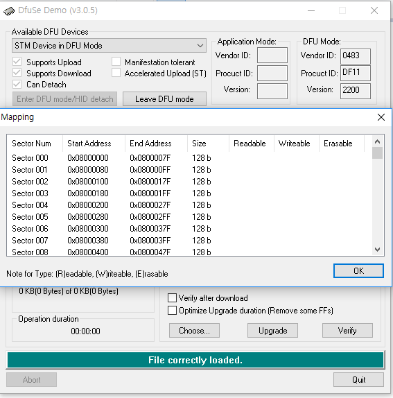

I am testing with the ST Discovery Lora Kit, B-L072Z-LRWAN1.

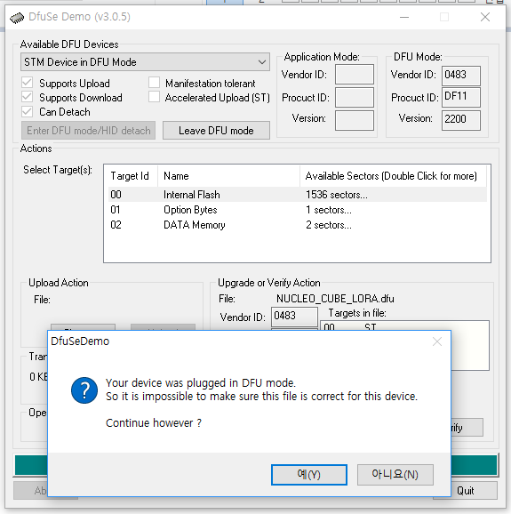

Dfuse Demo (v3.05) does not download firmware properly.
The error message is shown below.

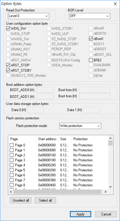

The following image is the contents of the option byte.
There is no revision.A similar error has been found in the STM32L0 series.
Is there a problem with the STM32L0 series?
Please give me the solution to the above.
