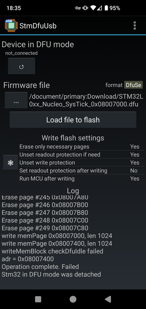

Unfortunately USB DFU Upload doesn't work with my Smartphones (Samsung), using Android application StmDfuUsb from https://yatrim.com/stmdfuusb:
- DFU download (flash to file) works
- Flash Erase works
- DFU Upload (file to flash) doesn't work (please have a look at the screenshot)
In my microcontroller application I can see that function Flash_If_Write returns 0 once (after writing the first 1024 Bytes) and later never returns anything.
I'd like to know if anybody could get working Android application StmDfuUsb together with STM32L0 devices and USB DFU_standalone example.
Is it a problem of the Android application StmDfuUsb or is it a problem of the microcontroller firmware. What debugging options do I have. I'm not really familiar with the USB DFU protocol.

2024-12-14 8:10 PM - edited 2024-12-14 8:16 PM
It seems that my post was misinterpretative.
I'm not talking about the factory embedded DFU bootloader, which some microcontroller include. I'm talking about the software USB "DFU_standalone" example, provided by ST, which should work with any USB capable STM32L0 device.
And my intention is to figure out if the microcontroller application example is buggy of if just the the Android application doesn't work correctly. My question was, if anybody could get working Android application StmDfuUsb together with STM32L0 devices and USB DFU_standalone example.
