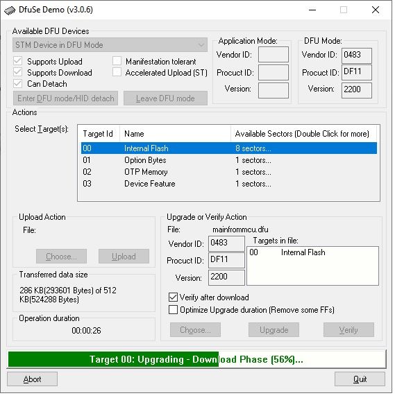

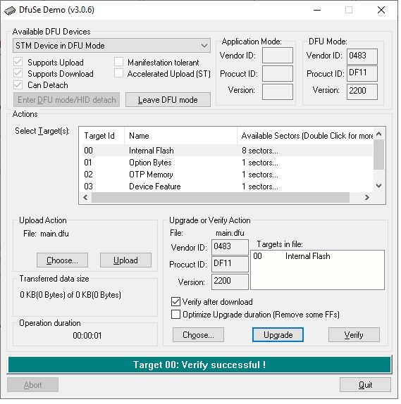

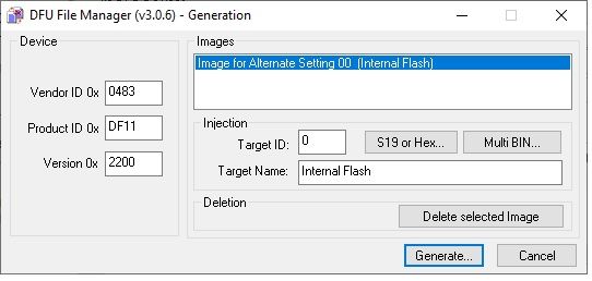

From despair I conducted an experiment. I flashed my chip via ST-LINK. Then ran the upload action from the chip to backup.dfu in DfuSe Demo. Then erased the chip by using ST-LINK. And flashed backup.dfu back into the chip via DFU mode. It works! It means that the convert function from .hex to .dfu in DfuFileMgr doesn't work. And HSE clock selected correctly. What could you recommend?

Failed to create dfu file. The only option I see is flashing through ST-LINK and uploads DFU file by using DfuSe. Very strange.
