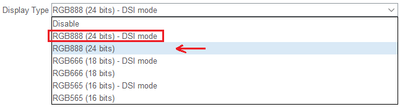

when I try to create the IOC file I have some problems with the FMC setting for the SDRAM.
All the peripherals end with the green check instead I have a warning on the FMC and so I don't understand whether or not I can use this processor with these requirements.

Because you selected LTDC in DSI mode:
So select the line in the next indicated by an arrow.
